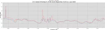

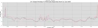

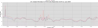

There were two test carriers few minutes ago:
First one on ~11025 H, the second on 11161 H

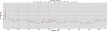

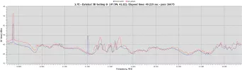

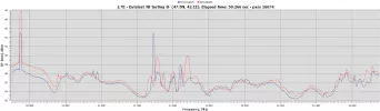

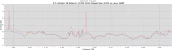

I receive active testing on all operating frequency range during last 2.5 hours (also at the moment). The frequency of carrier is fast changing.

More spectrums
