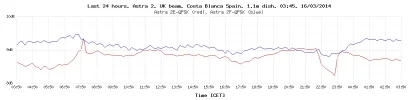

Here's what it looked like for me today on the 1.1m. No pixelization.

They're all at the same altitude, otherwise they wouldn't be "stationary". And the 0.15º just means 2E goes in and out of the shadow 36 seconds earlier.
Huevos, if you have the time, could you do a graph against 2e sd and hd over 24H so we can see the difference

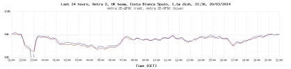

Just how low did the blue bar go!
Not quite as simple as that. The blue line is the average of the 3 8PSK transponders on 2E. That down-spike is one transponder (10862) going offline.The other two continued without problems.
The problem is if a transponder goes offline it shows as an 8dB drop when in reality it might only be a 1dB loss. Best thing is put this measuring back on the bigger dish.
