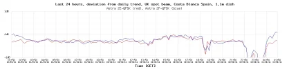

Huevos' graphs seems to confirm a drop in signal strength. Leaving aside conspiracy theories (a post on another forum implied that we shouldn't be commenting on 2E reception in public because it would give the game away to Astra and help them to fine-tune the spot beam to cut us out), I wonder what the cause is. This morning on the BBC news they reported unusually high levels of air pollution in the UK caused by anticyclonic weather, as well as a large dust cloud coming up from the Sahara. Could such conditions affect satellite reception?

That is BS. If you subtract today's reception from reception in February it tracks a line just below 0dB. Now do the same with 2F and it tracks an almost identical line. That means any difference is not due to a change at the satellite, but a change in the path between us and the satellite.
BTW, the dip after 18:50 is due to local weather conditions. And the big dip around 23:00 is from going into the earth's shadow (which obviously wasn't happening in February).

That is BS.
Yes, it goes without saying that the idea of SES might do this is delusional.
The previous graph seemed to show more of a deviation. Huevos, do you have the deviation graph comparing Saturday 29/03/14 with February? For most of the day I was unable to receive even the majority of SD channels, despite the lack of observable causes such as bad weather.
A cloud of sand travelling up north from the Sahara to the UK could concievably pass over our heads between us and the satellite. Hence my curiosity as to whether such a phenomenon, which is not that usual, could affect the signal received.
