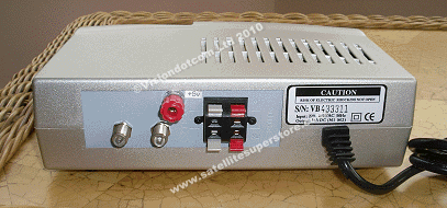

Old 18-06-2007   #7
Join Date: 29-11-2006
Location: Cheshire
Posts: 149
Thanks: 9
Thanked 5 Times in 5 Posts
My System: 1.2m CM, 36v Positioner, DB7020Si. Diablo, CAS3+
The technomate Llew does have the 5v, (second one not the first on the page) as can be seen in this picture
http://www.satellitesuperstore.com/i...tevboxback.gif
Rgds
PJ

Old 18-06-2007   #8
Llew's Avatar
Join Date: 01-01-2000
Location: East Anglia
Posts: 4955
Thanks: 17
Thanked 238 Times in 221 Posts
Blog Entries: 1
My System: Triple Dragon with HDD/USB stick, Humax HDCI2000, Echostar AD3000ip & SR8700, Fortecstar 5100CIUltra, Aston Simba, RSD ODM300. Swedish Microwave 1.2 Motorised dish / Invacom C120 twin LNB driven by the AD3000. 3 other fixed dishes. Diablo/Mrev Cams
Fighting the evil 3 Dragons under the Don Quixote banner,Sir Llew persevered where others failed
Apologies PJ02. Should've checked down. BTW that site should be up for the 'Most Cluttered Webpage' award
