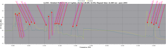

Two more (S2X extension) muxes have been activated:11033 V,32725,13/45, S2X and 11411 H,30000,13/45, S2X-Data.
Finding the signal parameters in the upper band is still impossible.

Active transponders at this moment with TM-5402 M4
