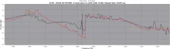

today was quick signal 11655h 1.5 db and gone
