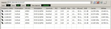

The only channels that I get just now are.
Badinan tv. 11186V 2289 3/4.
DUHOK. 11188V 1774 3/4.
TM5402HD.TD88
The TBS 6925 Only gets DUHOK on the TD88.The longtitude probably needs tweeking a bit.
First two picsTM5402. Third one the TBS scan

At this time of year only my TD88 can get to 57E ..
4 data transponders found in the vertical with the TBS card ..and Duhok being the only TV channel I can lock..
Solid lock though ..
7.4db on the TBS card
