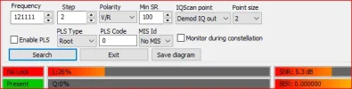

9,45 db needed for lock, getting 5.2/3 db 1.2 dish.

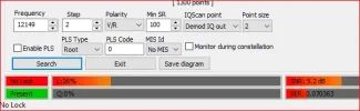

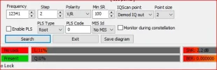

I hate this satellite. I get 7dB from Nordic beam on 12149V but no lock. I barely get 1dB from 12111V - no idea whether this is Nordic or Italian bleeding over. Italian beam 12341V - 4dB - no lock.
12111 1.9dB
12148 5dB
12340 2dB
Occasional detection of 12283 27500 8PSK
All V, No locks, 1.5m PF

12111 1.9dB
12148 5dB
12340 2dB
Hi - Pretty much the same here on 1.8 c.m. for those transponders ...
The 2.4 manages to lock - 12148 at 9.9db (0.5db margin)
