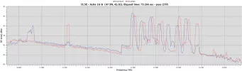

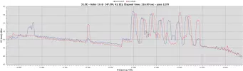

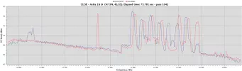

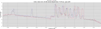

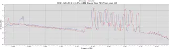

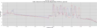

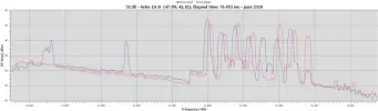

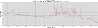

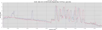

Last evening and night there was testing on band 10950...11200 and 11200...11450 MHz.
Right now 11200...11450 MHz tests again.

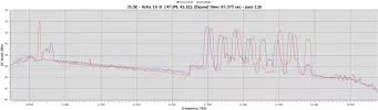

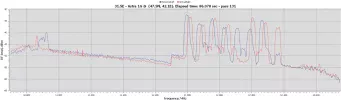

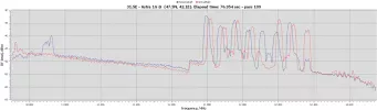

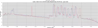

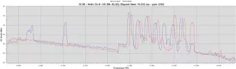

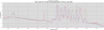

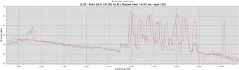

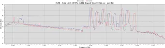

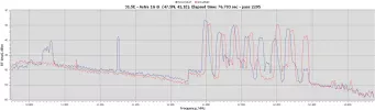

Finally Band A (10700-10950 MHz) was tested an hour ago.
So, Eutelsat 21B can operate in whole low band 10700...11700 MHz.

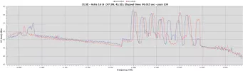

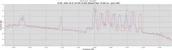

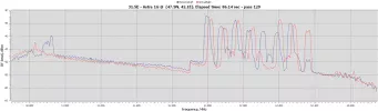

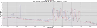

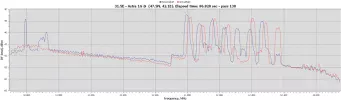

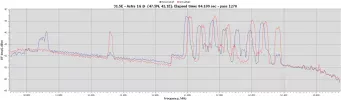

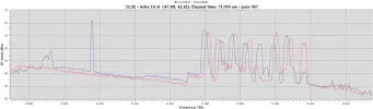

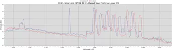

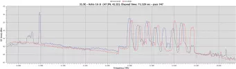

There was new tests on Monday and Tuesday, new spectrums from me )
Subband 12500-12750 MHz was tested also. Thus, Eutelsat 21B can operate in 10700-11700 and 12500-12750 MHz (all FSS bands).
There was only 20 minutes of tests today. Seems the testing goes to finish.
