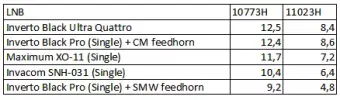

The big question is: which LNB is really the best with a 1,8 m Channel master right now? Inverto Black ultra single, Black ultra quad, Opticum? What do you think?
Yes, which one?
As I had the meter and screw-driver out near the CM180 this evening, I ran through the LNB-bin to check a few options on 2E / 2G reception.
Each LNB/feedhorn was mounted, adjusted to maximum C/N on 10773H (first focal-depth, then skew).
1) Nothing surprising at the top - the Inverto Black Ultra (Quattro) does the job really well.
2) Somewhat impressing is the almost-ran contender of the Black Pro C120 + Channel master feedhorn. Virtually equivalent to the IBUQ.
3) Even more impressive is the performance of Maximum XO-11, which is about EUR 4, I think. (probably has a plastic feed-horn and cheap components. But still a very good price/performance.)
4) The Invacom can't really keep up the pace here. Not worth the premium.
5) This was most for fun - the XMW feedhorn is designed for 0.45-0.65 f/D dishes, but is probably over-illuminating the dish.
So, what are your findings?
Yes that is impressive. It may have the same internal components as the Black Ultra.
The Invacom are unusually bad, they are normally better that that.

I don't know about larger dishes but a converted IBU definitely outperforms a Black Pro one on the Fibo 120.

I had a lot of problems getting 11386 H and 11097 and 11126 V at the same time. I was able to get a maximum of 8,2 dB on 11 386 H which droped to about 6,9 in the evening. When getting 11386 I couldn´t get 4 seven and ITV HD. Spent a lot of time adjusting the position and skew of the LNB. However it seemed impossible to get all channels.
Decided to try a Inverto Black Pro together with my original CM feedhorn. I ordered the LNB from Finland (at a third of the price for exactly the same LNB in Sweden).
Now I have tried the new equipment and there is a big difference. It seems the Black Ultra I used earlier can't manage the transponders using the same frequenzy with different polarisation.
Now I can get all TP:s (even 11053 H which is the weakest TP of all with 8,9 dB ) with pretty good margin. E.g. 11386 H is up from 7,7 to 9,8 dB, 11097 V is up from 6,1 to 10,1 dB and 11126 V is up from 6,9 dB to 10,1 dB. Generally all TP:s are up about 0,5-1 dB however some of them are up about 2 dB.
On the European beam there is no big difference apart from 11836 H which is up about 1,2 dB.
archive10
Interesting. I recently checked the IBU and the Black Pro with CM feedhorn, and they gave roughly the same results.
I didn't, however, compare cross-polarisation performance. But it makes a lot of sense if the CM feedhorn is better - it is after all bigger and better defined -> matched to the dish.
