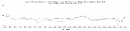

Don't know about that. Apart from the eclipse problem at night that people have been reporting there seems to have been quite a bit of variation in daytime signal strength over the past two or three days. On Saturday I couldn't get any channels at all for the central part of the day. Yesterday was a bit better (but couldn't watch the F1 on BBC) and I could get most of SD channels most of today. I haven't been able to get BBC HD One or Two since last week. I thought there was a problem with the wind causing misalignment on Friday night until I checked it was okay and then saw reports of the same problems on another forum, but mostly people in Germany, France and Italy. Has anyone else here in Spain noticed anything? I read something about a CME (Coronal Mass Ejection) on spaceweather.com and thought maybe that could have an influence.
I have noticed on some of the dishes I "look after" a drop in signal on some sd txp´s and have had big problems with BBC 1 and 2 UK HD txp´s. Could be me, but I figure "Satellite Freak" will post a graph and prove us all wrong!

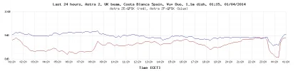

interesting that the 17:00 drop has vanished, by about one hour! could be clock change! he he!
Archive4
jokes aside, the 18:00 drop is nothing compared to midnight in las Vegas, how long will that go on for?
