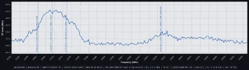

After a long time ... my 120 cm dish set fixed at 16.0°E.
Signal comparison: 2.20 m and 3.70 m. The difference is not significant.
