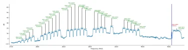

my scan in L
I have a little bit interverence in the near from 3500 to 3600 GHz. I can't lock.

Great, your spectrum looks clean, even if you say you have interference at 3500-3600 MHz. I don't really see it. I think the last active is 3576 L below 3600 MHz. The ones reported on KingofSat don't seem to be valid anymore(?).
There are a few frequencies in the Right pol that I haven't seen locked in any report, at least the ones that show up on my spectrum. They're shown in the analyzer below. One of them, 4015 also appears on the Left on yours(?!).
