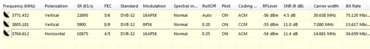

@John - any chance of a scan today here? Scanned it here but only locked a couple of data transponders (at 11dB!) - no picture/audio :(

Thanks John. My scan... nothing exciting. Still to see a picture from this:

Yep, it's doing very well. I can see the signal on the analyser & Iv'e just had a tweek for max but i am about just over half a dB short of the minimum lock of 5.5dB for lock.
A screen grab of received signal info would be helpful to see how much more the FS is getting.... is it being helped along by the southern UK location which shows a tad better strength ?? Certainly doing well from Sussex.

I've not done a scan on the 1.8 @blademedia The only one I have is from mid week and taken on the 2.4.

With some careful tuning last night - i got the data transponder up to 12.2 db ... but still not a hint of anything else ... think i,m too far north west for channels from this satellite ... the recently setup 2.4 will not get this sat either .. the view is mostly blocked by a building .
