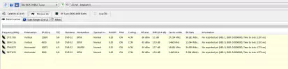

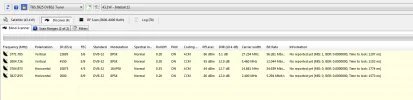

i am found 6 horizantal and 4 vertical transponders with dm920
