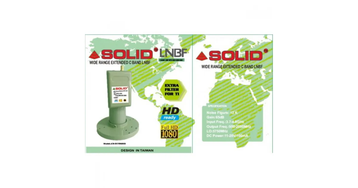

This LNB might be interesting. It has the extended frequency range with an additional 4.5 - 4.8 Ghz and a 'TI' filter not '5G' ... Unfortunately only available in India
forget these lnbs
I have 3 and all three suffer from the 5G signal
I replaced them because I couldn't see any channels
the tbs stored them the tp but they were not visible
I memorized the tp at 40 west above 4.5 ghz
with strong signal but no picture
I have 3 for sale if anyone is interested
and maybe even 4
get it from india
35,626
8,586
forget these lnbs
and maybe even 4
get it from india
That earlier link from satfaca (Tracksat) appears to be peddling similar items under the 'SOLID' rebrand.

what has been linked does indeed allow 5G to pass
that of Satfaca is another model with a 5 G filter

More than one product, pure promotion.
Prices are no higher than 25Euros
with this charming caveat
Warranty: There is no warranty on LNB, Switches, and Satellite dB meters.
