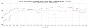

Current orbit is slightly elliptical so 2E has a daily cycle wandering between 28.30 and 28.42.
I realigned my 1.8m dish yesterday. Graph attached. Look at around 17:30. Picked up lots of signal on 2E for almost no trade-off on 2F.
