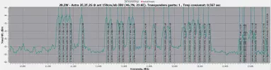

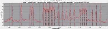

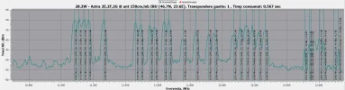

If there are users in the south-eastern part of Europe interested in the European beam at 28.5E,this is what the signal looks like in my area:
