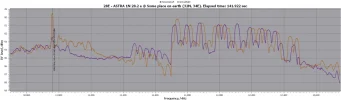

Astra 2F at 28E (at last!)
BlindFaith
Oct 2, 2011
639
309
TBS 5925
Inside the spotbeam you could call it deep sea diving ;)

Nothing here yet but I guess when transponder(s) get lit up for testing a host of reports will be coming in from the spot-beam area.

im getting it dead on 28.2e as i said ill try check again tonight the power coming from it is weak but something is coming from that frequency cant say what
6,036
1,273
I cant see it on my 1.8m fixed, but can on the 1.5m motorized about 0.5º west of the slot.

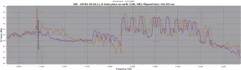

i got uk beam very strong 7 c/n 10961h
Highly unlikely, seems more like overspill from neighboring frequencies
