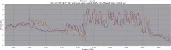

I did a few tweaks this morning:
Added LNB umbrella for the rainy days to come.
Added 13dB attenuation to try and limit co channel interference from the surrounding 1N TPs.
Minor azimuth adjustment of the dish.
This is the signal quality measured today:
This is very similar to my reception yesteday.
I'm wondering about three things at the moment:
1. Is the Beam centered during the day or is it beeing moved around for measurement purposes?
2. How much are the TPs close by degrading reception?
3. Hopefully the Horizontal TPs are the worst - and the Vertical will be significantly stronger.
