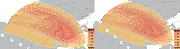

Here are the official footprints of 2F and 2E side by side: 2E's beam is slightly further east (2E just touching Spain there, while 2F is not), than the one of 2F. Is that due to the different of center of Box 28.2 / 28.35 ?

I have tried to merge them both. It was a bit difficult because the underlying maps didn't match 100%.
Blueish with withe lines is the 2E, the 2F footprint is merged and shows in orange and colored lines.
To me this doesn't represent our situation here at the eastern border. 2E here is always about 2db stronger that 2F.
