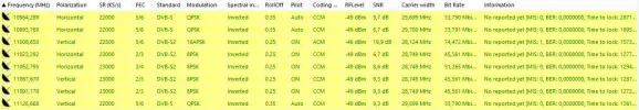

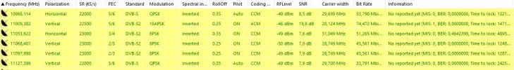

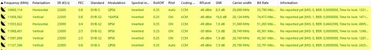

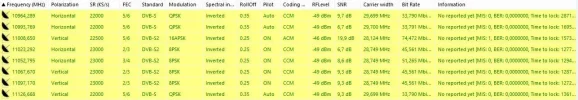

Scan at 16.45hrs this afternoon shows :-
compared to 08.05hrs this morning :-
Ouch!! :(

Earlier today no relevant change. This afternoon:
10.964H Channel 5 normal
10.994H ITV down
11.024H BBC gone
11.053H ITV gone
11.067V ITV normal
11.097V ITV normal
11.127V Channel 4 normal
Will make an evening report, when the level drop is at max here.
6,036
1,273
John, which dish? Have you centred the dish on this satellite?
Archive4
Lost the BBC HD's here on 11023 H 23000... It was there on a scan at 08.05hrs this morning!
Must dash now...perhaps somebody on this coast could check their reception....thanks.
