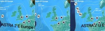

Just done some checks here at home on the new interim 2G TP's - TP90 is lower in quality than 89 and 92. I believe that 2G has two levels of PE footprint power-wise, a 'high' and 'medium' level carrier. Can't give actual EiRP levels in dBW as SES don't publish this but possibly TP90 is on lower power, maybe same goes for the migrated TA1 - TA4 TP's.Im a bit surprised just how feeble the 2G European beam is compared to 2E & 2F Euros as well - one of the frequencies moved overnight has actually gone done half a dB here compared to 28A last night! The other three have only gone up ~0.5dB
