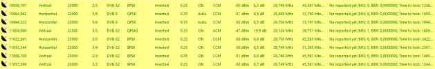

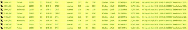

....... armed with the Emitor, using constellation mode .......... Did notice I could improve 11023 H with focal adjustment but had detrimental effect on 2E.
Morning Brian..........overall are you pleased with the Emitor.......¿any negatives with it for yourself?
Assume the 'Signals are lower this morning' are readings with the 1.4m.
Will see a friend later with a 1.4m on Urb. Da Vinci (behind Mercadona)...will be interesting.
