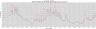

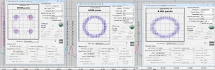

At this time we have three test carriers on Astra 5B at 43.5E:11745 V,12035 H,12056 V;

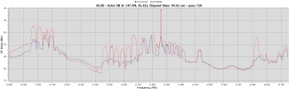

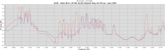

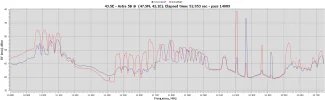

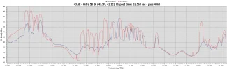

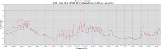

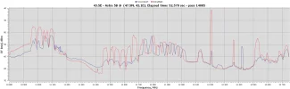

I can confirm test carriers:
11745V
11785V
11823V
11862V
11900V
But I had nothing on 12035 H and 12056 V.

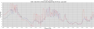

From the logs today, tested transponders: 11739V, 11817V, 11856V, 11900V, 11934V and 12031H.

Another one at 12246V
12285v active at the moment

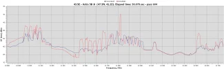

12073h active at the moment

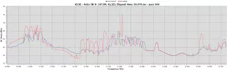

11764H active at the moment

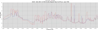

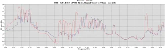

Another tested transponders: 12400V, ~12480V, ~12440V, 11900V, ~11740V, ~12160H,

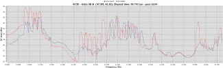

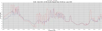

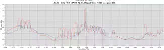

12054V, 12166V, 12264H, 12443V active at the moment in wide-carrier mode. Maybe all carriers are modulated, but can't check this because of weak signal levels for me.

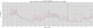

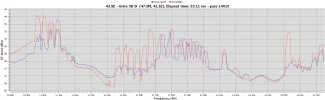

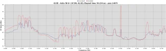

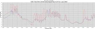

Today we have another set of test carriers: 12166V, 12206V, 12264H, 12360V, 12418H

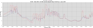

Test carriers 12206V, 12266H, 12362V, 12420H, 12441V are active today.
