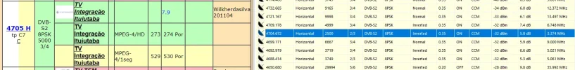

65West Extended C-band.
4704.5 H. 2500. 2/3. DVB-S2 8PSK. - FTA.
TV ALBA 1.Seg - - Vpid:358. Apid:359. Sid:1000
TV ALBA HD - - Vpid:258. Apid:259
No sign of adjacent channels on 4705 H.
