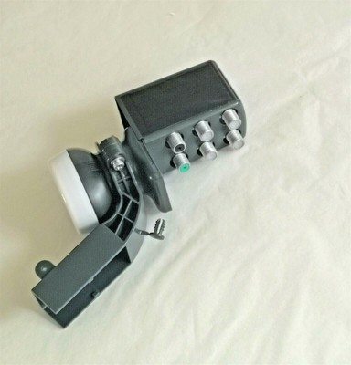

Keep your current LNB until the Sky contract is over, I don't believe the Q box works with a quad LNB. But yes that quad LNB will work with any Freesat box when the time comes.

There's a hybrid lnb on the bay going 'cheapish'
If using a Freesat 4K recordable box, to maximise recording options it will have to be connected to the wideband outputs of one of the above LNBs (not the quad). If using a quad LNB with a Freesat 4K recordable box it will be limited to recording a maximum of 2 channels simultaneously.
