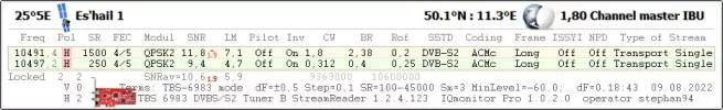

as often on Sundays, there is a lot of action today among amateur radio stations.
Not easy to get a picture with sr 250 , today i succeeded
25°5E_2208091843.webp25°5E_10497_H_4323.webp25°5E_2208091843_10490-10508 H .webp

I am using a tbs6903 and I can receive amateur radio TV transmissions at 10400 - 10500 H by setting (as suggested in a forum post)
IFStart=250
IFStop=2350
LNBMid=9500
LNBStk=21000
in streamreader.ini on ebspro.
Can I leave this setting on other KU band satellites as well, or do you think it might worsen satellite reception?
If you're only interested in the downward extension, you can set the following values:
IFStart=600
IFStop=2150
Nothing changes for the rest of the Ku-band.
However, to receive the amateur frequencies of the es'hail 2 satellite, you must make sure the LNB does not have LTE filters... otherwise, it won't be able to receive anything below 900 MHz.
