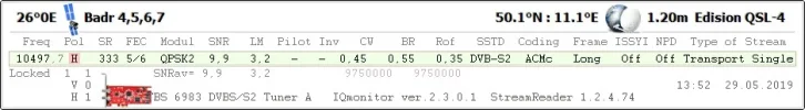

Es’hail 2 25.5e
it's not Roland Garros
but only Roland (DG1MAJ)
10497,7 H
333 5/6
QPSK2 DVB-S2
26°0E_1905291352.webp26°0E_1905291352_10475-10514 H.webp26°0E_10498_H_4918.webp
10493 H 2000 2/3 DVB-S2/QPSK MPEG-4 Es’hail-2 @ 25.8° East
10498,76 H
sr 333
DVB-S2 QPSK2
FEC1/2
M0SKM
