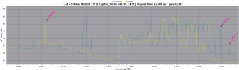

Two test carriers with fluctuating signal appeared at 1,5°E. Frequencies 11575,11 H and 12528,44 H.
11575 H
12528 H

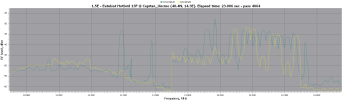

Three test carriers have been activated for a few hours.
11035 V
12585 H
12665 H
