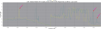

Two test carriers with fluctuating signal appeared at 1,5°E. Frequencies 11575,11 H and 12528,44 H.
11575 H
12528 H
