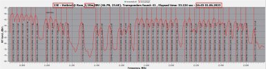

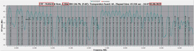

Signal test on muxes on Hotbird with 1.10m antenna in my area:

Looking at the spectra posted, I notice that the weakest signal is 12728 H,27500,3/4; in my area, the SNR is just over 7dB with 1.10 dish.
Also, in the upper band, I notice that some muxes with S2X extension are activated, with insufficient signal, which poses reception problems.
Note a new Data trp,at12665 V,15716,3/4, Multi 63.
So for the reception of these, you need a big antenna.
