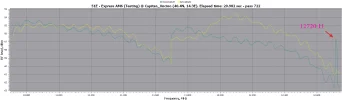

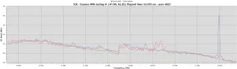

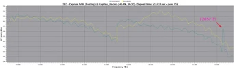

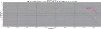

First test signal for Express AM6 at 51°E, Frequency 12532 H
Visible beacon Ku-band at 11199.50 RHCP

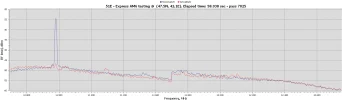

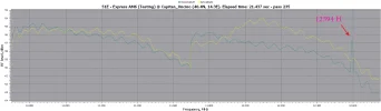

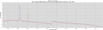

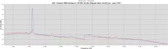

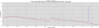

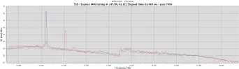

11043H active right now. There also was carrier 11215V few minutes ago, but gone now.

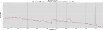

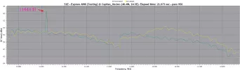

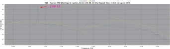

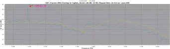

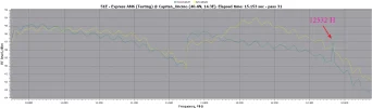

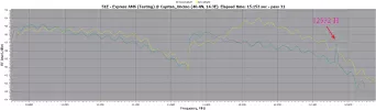

Test carrier, 12594 H, 12657 H, 12720 H, 10981 H and 11044 H

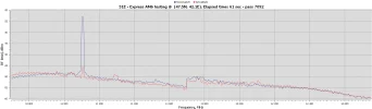

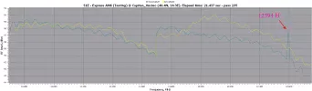

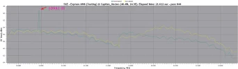

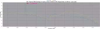

11106 H half an hour ago, 11169 H now.
Height on Crazyscan RF level scale: 2 and 1 dB respectively, so not very strong.
Edit: 11169 H also 2 dB now.
11106 H and 11169 H

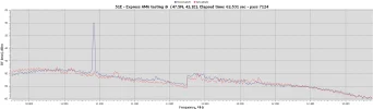

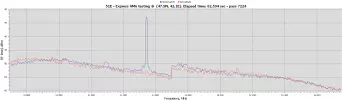

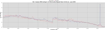

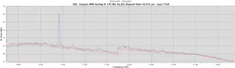

For comparison, test carriers 12530H, 12594H, 12657 H, 11360V, 12720 H, 10975 H, 11044H, 11215V, 11104H, 11167H from my location (0.9m dish)
Interesting New activity in the 10.7Ghz to 10.95GHz part of the Ku band not used here before ,
I hope there is some new content on the European Beam.

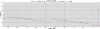

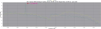

11481 H now, started 1 dB, a couple of minutes later 2 dB, so there's a pattern, a careful switch-on of transponders!
Since the peaks are so strong at tempo, I think these are Russian beam, and there is little hope for reception here.

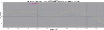

11482 H

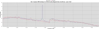

11543H
