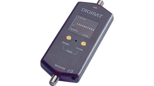

Without a basic meter or the ability to see the signal levels on the TV you'll find it difficult to align the dish accurately.

Happy to buy the signal finder and LNB. In for a penny in for a pound at this point
