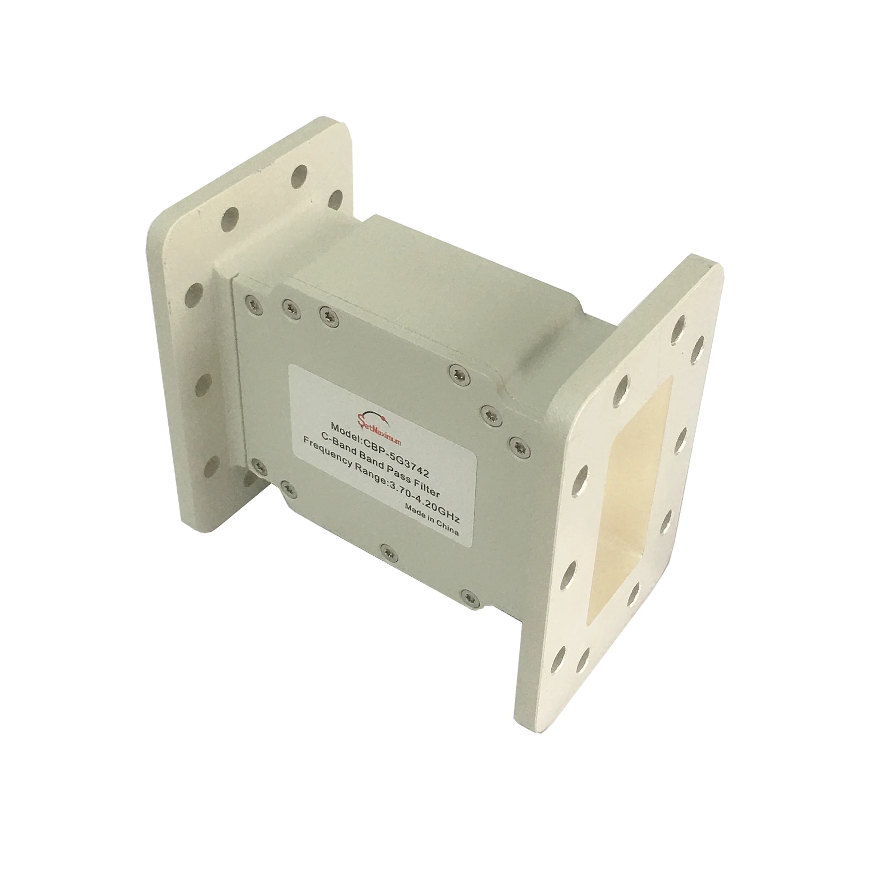

Just to add - when you get down to the 3.700 GHz area and below that's when you might get the dreaded 5G interference causing havoc. Iv'e got a 5G tower very close to me and it does cause me problems.
Yes, this is what I get on 3720H - an otherwise perfectly watchable picture completely ruined by interference. Is there a way to filter it?
I don't have this issue above 3800-ish.

When i first dabbled with the reception i got quite bad, and still do, 5G interference knackering things up - i installed a AliExpress external 5G ilter before the lnb, that helped me get more stable watchable pictures and was also helping me grab & lock some digital channels as well from 70West - the snag with that set-up though was the fact that the external 5G filter was only factory usable up to 4.2GHz and rolled off and attenuated very quick afterwards which meant i couldn't use my Norsat 8000RI 3.6 to 4.8GHz lnb ., so now i'm running without the filter and not getting the best results possible on the PAL analogue stuff
11,808
7,991
I am a pleb so only bog standard LNBs here.
Do you have a link to this filter?

Thanks John, I'll take a look. The bottom end of the range on this satellite is definitely stronger than the top end. There's some more tinkering to be had but with the amount of pulsing I see on analogue, I don't see how digital would lock with any sort of reliability.
