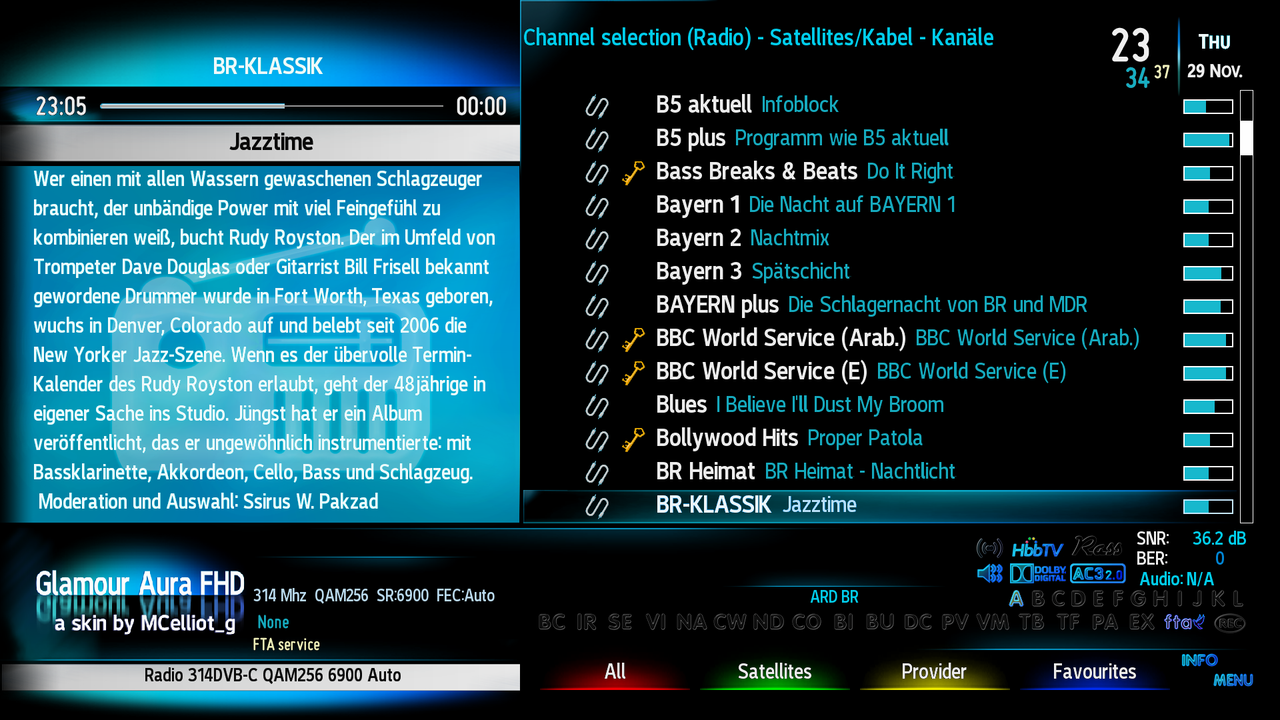

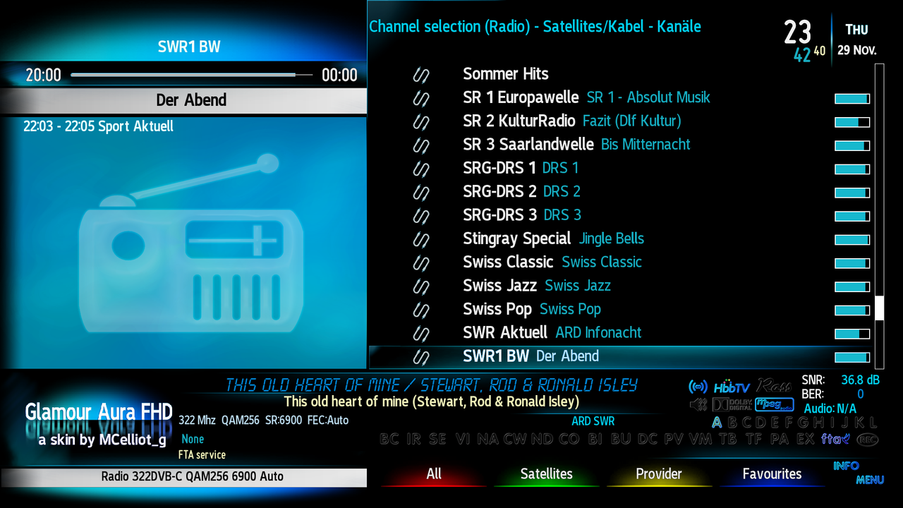

I had changed "Hide channel list in radio mode" because you can listen to radio without showing any picture and zapping is also more comfortable.
So now I have set it again to On and this is the result:
But I consider once again the initial problem crashing when returning to TV mode.
Hmmm, you still have the previous version and I don't know why! The new version (provided by the new IPK v28) has a different rearrangement in the radio screen, same as screenshot from post #24!
And this is exactly why you have the crash, I've fixed it in v28!
