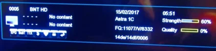

Thanks & here's a couple of "interesting" equivalents from 21.5E - the first shows the programme screen with Info pressed and the 2nd shows the Antenna Setup screen on the same transponder, but compare the Signal numbers = totally different!
If you can't read the first one, it says "30%" whereas the 2nd one reads "90%":-rofl2
Anything like that "difference" on the Freesat?
