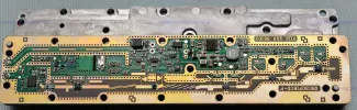

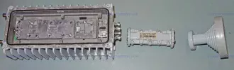

I put a Prodelin 3122 Ka dish on the CM1.8 polar mount. I could not work out how to get the Viasat ODU working so I bodged a Gilat 2.5W ODU on the platform.(only the RX connected - it wasn't me @Llew). The sky/ground noise figure of the whole thing measured about 2.9dB, not fantastic but it has all the diplexer stuff to get through. The dish is 0.8f/d, I think, so I'm not sure how well the Gilat feed is matched.
