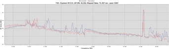

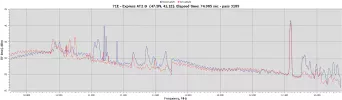

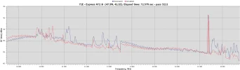

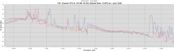

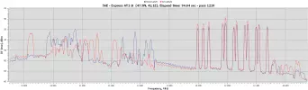

So, this is full list of all transponders of Express AT2 (16 TPs):
12187L
12207R
12226L
12245R
12265L
12284R
12303L
12322R
12341L
12360R
12380L
12399R
12418L
12437R
12456L
12476R

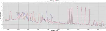

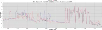

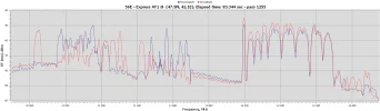

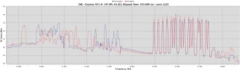

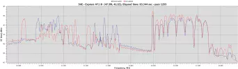

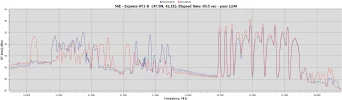

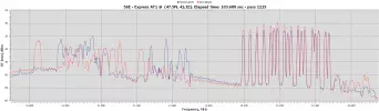

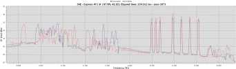

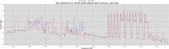

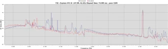

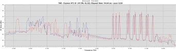

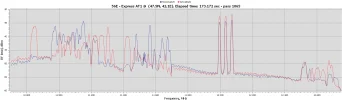

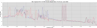

Last midnight (by Moscow time) all transponders of Direct 1R were switched off, then part of transponders of Express AT1 are switched on for testing and TV content filling. NTV Plus Vostok provider going to use Right Circular polarisation, while Tricolor TV Siberia will use Left Circular polarisation.
These carriers are active at the moment:
11996L, 12034L, 12073L, 12188L, 12265L, 12341L, 12418L, 12111L, 12149L, 12226L, 12303L, 12380L, 12456L (Tricolor TV Siberia).
12169R, 12245R, 12322R, 12399R, 12476R (NTV Plus Vostok).

These three peaks 11996, 12034 and 12073 are strong here in NL, probably another beam.
Nothing above these yet.

So for the record, with 120 cm and linear LNB, 11996L, 12034L and 12073L were booming in with over 15 dB S/N, after entry of symbolrate 27500. Not lockable though.
Since about noon UTC, the S/N of these three has dropped to about 3.5 dB.
No trace of anything above 12.1 GHz here.

I get three circular polarised transponders with IBU in Helsinki, strong signal with misaligned 110 cm dish. 12 dB with GB Quad nonsense decibels. Same channels found with V and H polarisation, so it's circular. I have same thing with TNV at 36E. All 15 are HD channels and six of them encrypted. DVB-S2 27500, propably 8PSK 3/4.
11996L 5 encrypted channels, 12034L 5 ch (1 enc, 4 FTA), 12072L 5 FTA channels. Using network search goes through several other transponders, but finds nothing from them, propably they are in siberian beam.
2,357
3,336
Yes I think so too. the three L transponders mentioned are wide beam , the rest is Siberian beam.
The three wide beam peaks are still here, but no dB reading any more.
Signal drop-off over Germany must be very steep according reports: in the East they are locked quite easily, in the West no chance.
