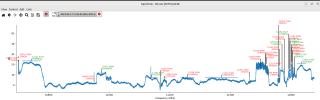

Test with neumoDVB 1.2.1 on 60.0E with the tbs6903x card.
I am getting a superb constellation of 32APSK at 10963 H,5000,3/4. Indeed, the signal is also above 20 dB.
Who wants to find and identify this position on the arc, take it as a reference.

Yes, beatiful constellation.

In Blindscan on linux with tbs cards the TBS6522 is being discussed, so I took my card out of retirement and installed it in the PC with the 6903 tuners.
However, there's no spectrum activity or tuning with the 6522. Checking an error thrown up in neumo.log, I may be wrong, but there seems to be a problem in setting the diseqc for the port I'm using, diseqc 0 (or any other port).
I'm using the same parameters as in the TBS6903 cards, which have no problem successfully tuning the same satellite (or any other ones).
There is no problem with diseqc using the 6522 in Windows.
@deeptho, perhaps you could check the neumo.log for clues to the problem? There's nothing in the console except the usual neumo.py loading options.
Perhaps you should first update the driver?

How do I make the TBS 5727 card show up?
I have neumodvb in Fedora 37 and the card does not appear in the frontend.
I have followed all these steps as well, but everything remains the same.
deeptho/linux_media
  • neumo.log.zip

I have followed all the steps, the .sh script as well.
