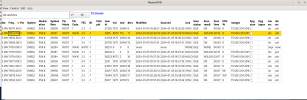

neumodvb working well enough now on my Raspberry Pi with the TBS5927 USB tuner since updating to version 1.41. Before 1.4, I was unable to have channels show any video on the RPi. Ubuntu now 23.1 new install.
A problem I am encountering is with MIS muxes on 5W. Blindcanning the satellite will show the non-MIS channels locked, but the MIS muxes need to be individually selected to lock. This may be a TBS5927 issue, as using a TBS 6903X on my PC has no problem with locking them.
The muxes that do lock after selection appear in the mux list, but only as one mux, i.e. not as individual streams. Occasionally they show as locked OK, but more often than not as Partial or Pending.I've no idea which streams were found, as the stream info column stays at -1.
Going to the Channel list, those MIS channels that did lock appear in the list, but are unavailable to view presumably because they revert to Pending in the mux list, confused no doubt as to which stream they are supposed to be showing.
If I add a mux in the mux list instead of spectrum scanning, I can add all parameters (sat, freq, etc. and pls mode, but I find it impossible to add anything in the ISl (stream) column (read only?), so scanning that mux just shows up as one mux found.
Channels showing video in the screengrab are the FTA ones. An attempt at showing the RAI VGR MIS channel yielded no video.
deeptho, perhaps there are clues in the log for anything that prevents the stream channels showing up?
I do not think 5927 supports multistreams.
For those interested in the USB 5927, it is good to know that this tuner is supported for MIS-PLS muxes under Windows.
Tests on Italian MIS at 5.0W.
And under Linux/Ubuntu, with the 5927 tuner, you can only manually scan and lock the signal on the MIS-PLS muxes.
I checked MIS-PLS at 5.0W with neumoDVB.
The only problem is that neumoDVB crashes when you choose the program to watch.
To find out the error, I provide neumo.log.
@Llew, leave the scan longer until the SID turns blue, although it finds the services. Only the NIT cannot be found.
I should have waited longer, thanks. I'll have another try on a mux.
I found that too when I did lock a channel.
It seems I was wrong and multistream is supported on this card.
And the channels do play for me...
Here you can seen it decoding 2 channels at once.
Automatic discovery of streams
There was one bug with stv091x (as reported by Llew and Satesco): isi-scan was not working (but it works after manual entry).
This has been fixed in the latest drivers, uploaded today (release1.1.2)
OK now with MIS isi scan on the RPi. Need some patience to wait for a lock on a stream (showed as off lock as I was downloading the grab).
Thanks for the update deeptho.
