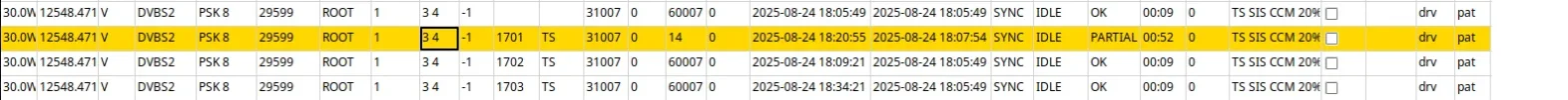

On the PC that I posted the mosaic from 11222H, I also have a problem with the Paramount Network mux (12548V) where, although the key is decrypted, no services are found. Scan result stays at Partial, and the other two pid results show OK but no services are found. Other muxes are finding the services easily enough.
I find that mux on 30W something of a problem with my setup. Maybe an LNB or cable issue, although signal quality seems good enough.
Works for me
Note that some of the advertised keys may be wrong. If you press ctrl-o you can see whether reception is ok.

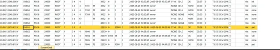

Checking the two weaker muxes at the high end, better luck with 12760V, although only two of the available streams receivable.
Will align 30W on another dish in due course.
