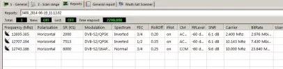

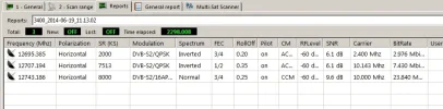

All that I get on this satellite are three data transponders.
12695H 2000 3/4
12707H 7513 1/2
12743H 8000 3/4
TB6925 100 cm Dish

Al Nabaa is the only channel that I have scanned in on 22W.It must have been a lucky catch.
I have not seen it since I got it.
