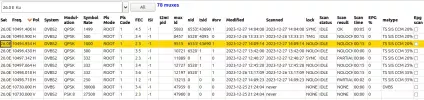

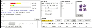

Indeed, you can scan and lock onto the signal on these Radio Amateur TV sub-band muxes using the neumoDVB app on Linux. This also applies to the 6983 card, especially on these low symbol-rate muxes.
