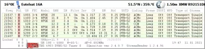

Yes it certainly does..here is some radio stations off 23E it downloads with a manual..Not sure of the upper limit..P1010017.webp

Yes it certainly does..here is some radio stations off 23E it downloads with a manual..Not sure of the upper limit..View attachment 134508

5 west 11458H 542 & 11465H 667
coming in loud (Octagon SF8008) and clear at 16.5db, its a shame the blind scan doesnt go lower than 1000 in E2

neither my SF8008 (E2) - nor my SX88 (non E2) can lock that one mate - not sure if its just a signal issue or an low SR issue
