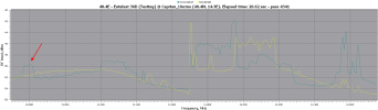

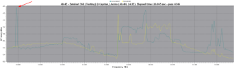

They have been testing on six frequencies since last night... 10739 V, 10784 H, 10867 V, 11609 H, 11692 V and 12742 H. The signals are not always active and change emission power very frequently.

10783 V test carrier
10785 H test carrier
10868 V test carrier
12625 V test carrier-new
12742 H test carrier
10704 V beacon
The rest are found by @Marcus_21 :Y
