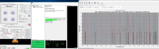

3984V 6.9dB
4047V 4.1dB
4089V 4.3dB
4162V 8.9dB

Ah, got ya. I'll try and find time to do a detailed scan on both dishes tomorrow but 4-6 transponders is fairly typical on the 1.8, last weeks scan on the 2.4 brought in 22 transponders.
thanks looks like the 2,4 wins hands down the precision is a quality dish
