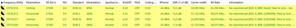

Thanks for that 'W' respect-048.gif ..........seems we are ok here.
1.2m dish, Badr 7 reception showing the same strength as Badr 5:-

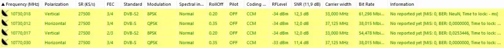

Slovenia, 1.2m Laminas...if this is really Badr 7 then it should stay like that :)..
Signal level cca the same as on Badr5. Badr 6 still the weakest in my area, but still some trp are receivable...
Humaxboy
