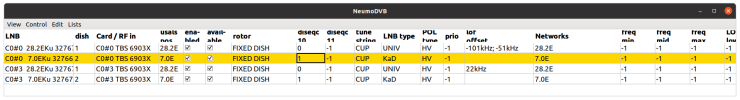

Quick test of Ka Band option in this version. We now have the respective Ka Bands available in the LNB Type column drop-down list, in this case for the test, KaD.
Test on 7E, (the New World mux at 21627 has disappeared at present). Not a lot locking for me, just the three.
