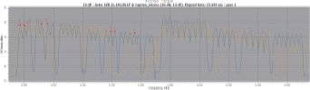

Unfortunately the weather conditions were not the best, there were continuous gusts of wind that altered the spectrum graphs. However I was able to take two stable images, depicting the spectrum before and after the changes, so I could compare them (image below).
From the measurements I just made, transponders 13,15,23 and 33 have changed satellite...
Unfortunately both the unfavorable weather conditions (gusts of wind), and the excessive proximity of 1KR to 1P, did not allow me to discriminate also transponders 53,55 and 63. In the next few hours, measuring the variations of the telemetry signals between Astra 1KR and 1P, when they will move away from each other, I will make a further measurement. Hoping that the weather conditions are favorable.
In the image, the overlapping of the spectra, of the deviations between east and west, with the alignment of the transponders I mentioned. I have marked with red arrows, those reported previously and black arrows those of Astra 1KR.

From this measurement taken at 17 UTC (18 Italian time), when all the Astra satellites were slightly distant from each other. By superimposing the image blurred by moving the disk slightly towards the west, with the one obtained by moving slightly towards the east, and aligning for power on the spectrum the txp 53,55,63,33,13,15 and 23, you can see that all the other transponders are no longer aligned... I can confirm that these transponders are on the new Astra 1P.
